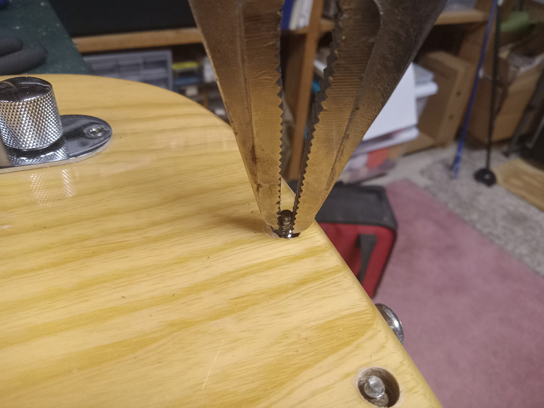

2. When installing the Extrem Vibrato one of the screw heads broke off. I know I need to extract the screw, so I tried to take one of the other screws out and the head on that screw broke off too!! Has anybody here had a similar issue and what did you use to alleviate it?

Okay, I fixed the guitar. I watched a few YouTube videos to help be get the broken screws out of the guitar. I'll go thru the process I did.

Next to get the screws out, I bought a set of diamond hole drill bits. I drilled some screws into a 2x4 to practice on. Then I drilled a 5/16" hole in a scrap piece of wood to use as a template. I mounted it to the guitar and started drilling. Once the holes were started, I took the board off and continued. I checked frequently to see if the screw was getting loose. Once the screw was loose, I took a needle nose pliers and started to unscrew it. When it was out far enough. I finished with some locking pliers.
